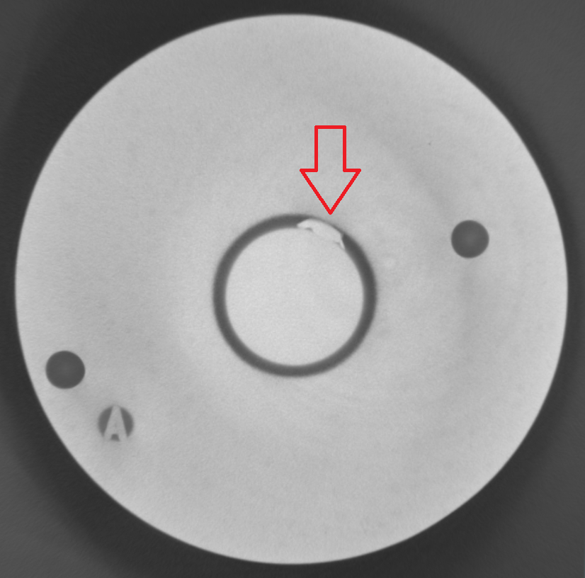

Yes, modding is always a risk. However, it appears the issue with the fuel rail is related to the internal coating of the fuel rails, and the material is breaking-down and contaminating the fuel injectors, which causes them to malfunction/stick. This can happen with totally stock OR tuned VR30s, running pump gas OR ethanol blends.
Now, does running ethanol blends exacerbate the problem with the internal coatings? Perhaps. Ethanol in itself is not corrosive, however, Ethanol attracts water. When the two get together, they create the perfect environment to grow a type of bacteria called acetobacter. The acetobacter then excrete acetic acid. And acetic acid is very corrosive.
I'd like to see the TSB they're referring to. I've had my Q since Dec. 2016. It has less than 24K on the clock so it spends a lot of time sitting in a garage in the high humidity of Houston. Seems I should have the perfect storm for fuel system failure due to ethanol.
