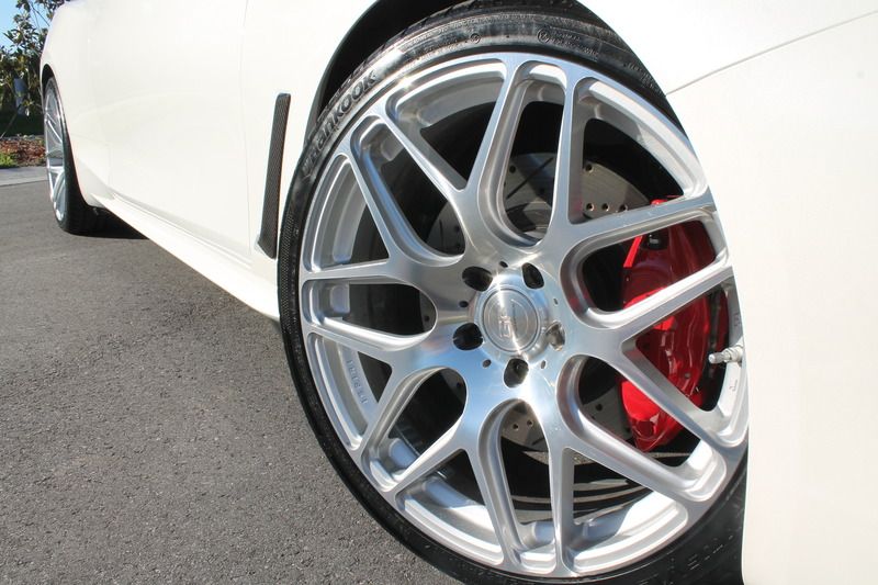

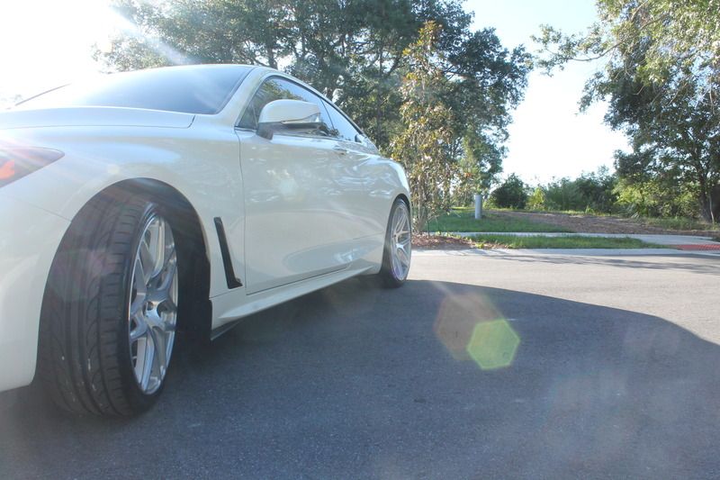

My Majestic White 3.0t Non-Sport Build So Far....
Dealer is going to love me on the first service :D
Akebono Sport brake kit
Stop Tech S/D F/R rotors
Stillen CIA
Tanabe upper strut bar
Black grill
Wrapped lower lip
Infiniti Sport exhaust w/muffler
Emm Tuning carbon fiber side vents and interior pieces.
MRR Ground Force GF9 20x8.5 5x114.3
ET15 CB66.1 Machined Silver
MRR Ground Force GF9 20x10 5x114.3
ET35 CB66.1 Machined Silver
245/35ZR20 95Y HANKOOK K120
275/30ZR20 97Y HANKOOK K120
Replaced the few halogen bulbs with LED
30% tints all around and 50% on the windshield
Next up will be a set of springs, rear deck spoiler and some bass in the trunk.

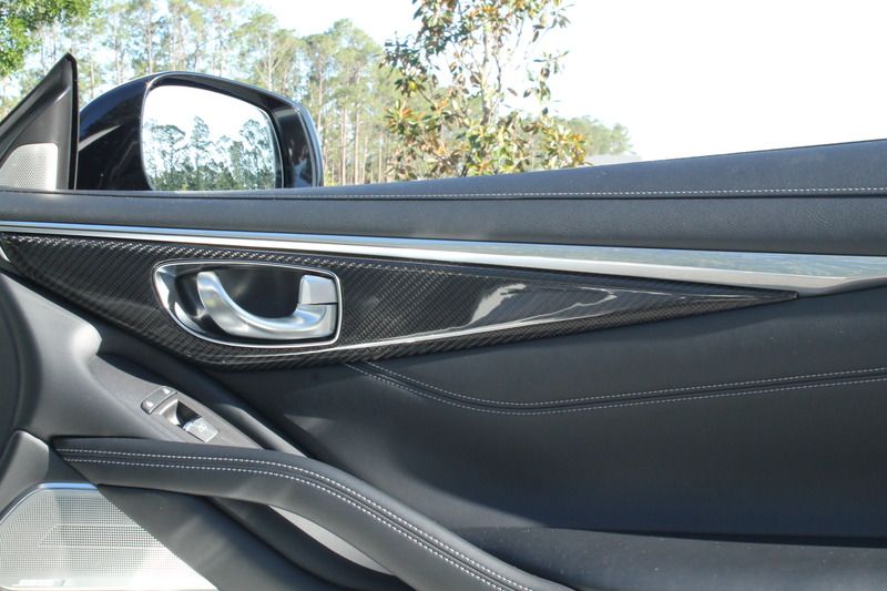

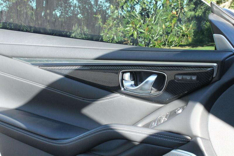

Nice! Dude, can you give me a walkthrough on how to take all of those pieces off? I want wrap my pieces with vinyl, but I'm deathly afraid I'm going to break the clips that hold them in place or scratch/dent the plastic parts.
Don't be scared to pull. Start with the side piece by your legs. Everything pops out nicely. Just go slow and see the clips come out.
I've taken off the side pieces by the center console before to install a new cupholder, and yea it just takes patience and luck, but how about the door handle covers? Do I have to get under there with a screwdriver or something? I'd like to do the window control covers too, but I see you didn't do those either...
Ah.. you will need to take the door panels off. There are about 10 screws that hold on the inserts. There are three bolts on the door panel. one behind the door release then one at the top and bottom of the door pull. need to take the cover off on both to access the bolts.
How did you find the door panels build quality to be? Do you think that someone can easily damage part of it during removal? I noticed that sometimes door panels are very fragile.

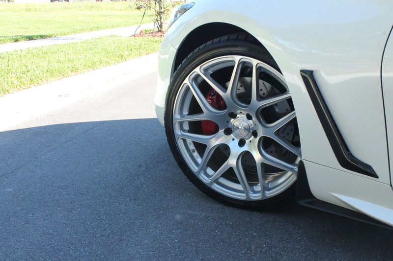

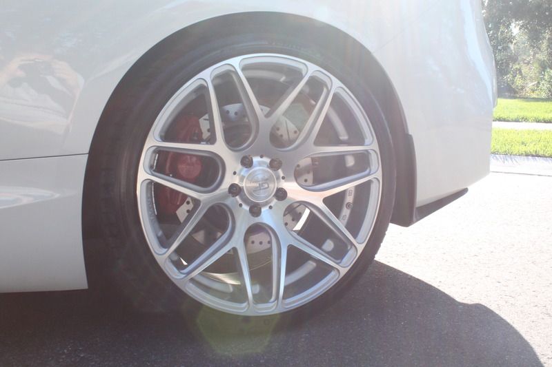

Also a question about your wheel setup - on the front you have 245's, any reason you didn't go with a 255? Was fitment an issue? I'm about to get some custom wheels myself and was thinking about doing 255 all around (I have an AWD).
